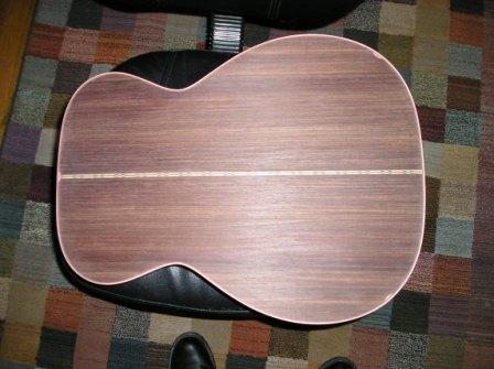

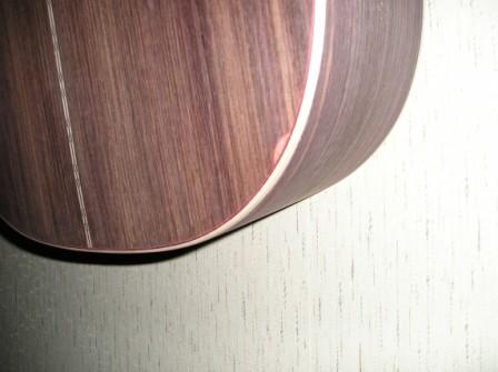

No need to ask how I know this but it is a good idea to not get in a hurry and then forget to put the screw in the bit ....or you might have to do something "creative" like this.....
I call them birthmarks!!!

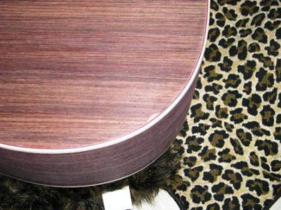

this is a better pic, I think. They came out clean but the real trick was in getting the second two to match the mistake!

Hard to see but there is red purfling that goes around the fig sapele "boot tips" as well as the around the binding. I got that sinking "OH NO" feeling when it happened then I just turned everything off and went inside and sat down

That's a tough repair I've never had that happen (yet) but I think I might repair it with a knot or maybe something commpletely contrasting. How did you fix it?
PostPosted: Mon Apr 18, 2005 12:34 am
Posts: 408
I used figured sapele for the rosette and thus also for the repair. The "thumbnail" (as I call it) was the same radius as a quarter so I measured from the center stripe to the other side, marked it and in an act of bravery used the same router bit (no bearing) to cut the adjascent "thumbnail" and then centered one at the top doing the same thing.....used alot of light!! The links below show clearer pictures. The recipient of the guitar just thought it was the coolest thing go figure!!
